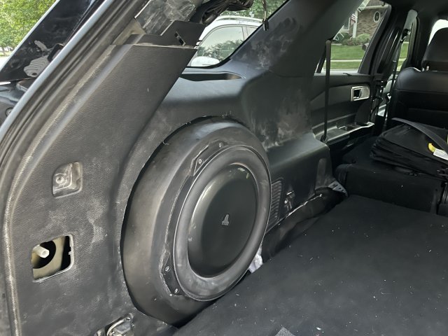

Finally got to the point of installing trim panels. I had to run my rear dashcam to the front so I was waiting to start with the trim panels.
Here's a shot of the sub. Need a solution for trim around the sub. Thinking about either a plastic trim ring or fiberglass it for a smooth transition. Also going to build a platform on either side of the box and carpet it like to top of the box so it continues to the trim panel.
51
IL
#59
you could make a ring shape out of wood carpet it and riv-nut it in place on the plastic panel from the back. That way you can follow the shape of the box, hide any gaps and hold the panel solid and keep it from rattling and will look like a continuation of the floor.
