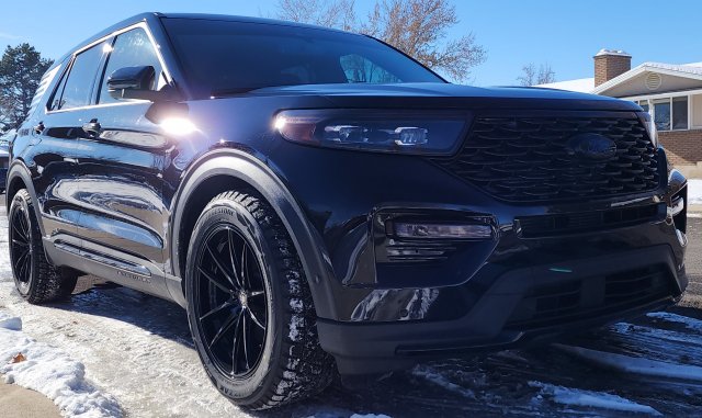

We've gotten a fair deal of snow recently. With the Explorer having been at the dealer, I haven't had to drive in yet, which is great since I'm still running summer tires. Ordered a set of Konig Oversteer in 20X9.5 ET25 in Gloss Black. Mostly since I couldn't find much that was available this year. I chose the Bridgestone Blizzak DM-V2 in a 275/50 to go with them. Should give a bit more sidewall in case of the accidental curb bump. I must admit, I like the price of these tires a whole lot more than the 315/35R22 :ROFLMAO:

When I had the tire shop install the new winter wheels/tires, I asked them to check the rear axle install and alignment because it felt funny, especially on snow. Dealer said there was no need to realign after they put the axle back on, but that sounded wrong. The alignment came back to show that the rears were toed in pretty badly. After the realignment and snow tires, it feels great again. It sure is fun to drive! Can't wait for the tunes in the spring!
