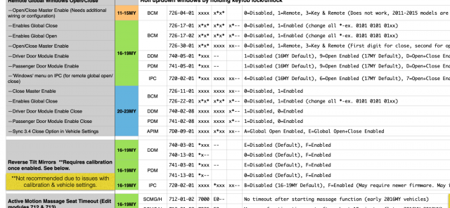

Hey everyone, so I recently turned in my leased 21 ST and picked up a 25 ST, loving it so far, only had it about a month. Just wondering if anyone has enabled the global close for the windows on a 25? I did it on my 21 using the instructions from the forscan spreadsheet and it worked perfectly, I really loved that feature, I feel like it’s a little silly that we can only open them with the remote but not close them unless you make the changes in forscan. Has anybody tried this yet on a 25?

I checked yesterday, the registers mentioned for the 20-23MY for the PDM and DDM do not exist in my 2025 Explorer ST.

ah ok, well thanks for checking!

I took inspiration from the screenshot you shared for the global close for the 20-23 MY and got it to work. Here are the details at the other thread.
https://www.explorerst.org/index.php?posts/104555
