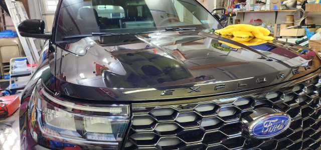

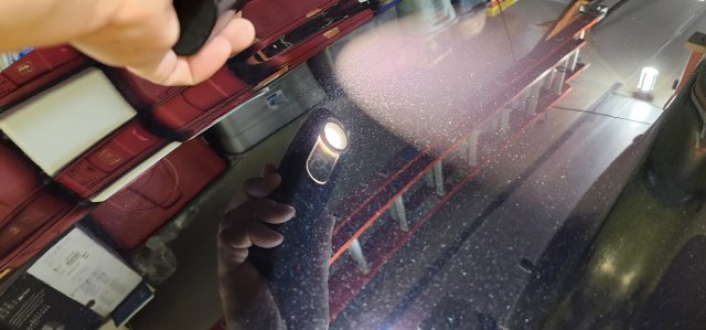

Off subject, but look at that finish after a very mild polish with Caliber Plus Silica Polish. This is probably the best paint job I have seen roll off Ford's line, especially Chicago! 20240825_175325.jpg 20240825_174402.jpg
