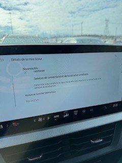

Ok guys, an UPDATE shows up this morning on my screen and the car is connected to the Ford network. Hope it's the good one this time....
Translation:
Improved Connectivity and Location Services. This update improves the vehicle's ability to maintain connectivity and location services.
Telematics Control Module

That was an update from a few days ago. Unfortunately for me I think my car either got stuck on that update which caused my problems or my car screwed up before they released that. Hopefully that update keeps ya from having the errors I did.

I would say, since the Feb. 22 update above, mine is working flawlessly.

If you scroll up you'll see that since December, I had intermittent connection problem with the Ford cellular network. I would say more often offline than online. Did bring the car to the dealer for a 48 hours re-programming, works for 1 week and failed. Finally on Feb 22, when getting in my car in the Costco parking lot, I saw a note on my screen saying that a new update have been done. Got that update over the Ford network even if I wasn't connect to it. Since then, no problem, never been disconnected. So maybe use your screen and look to the update section to see when the last one happens. If you have a February 2025 update, you should be good.
