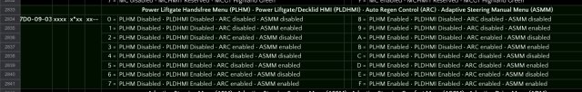

which line item under the apim 7do-09-03
Im wondering if it would add the option under the Power Gate Hands Free in the settings if enabled. I haven’t messed with it yet.

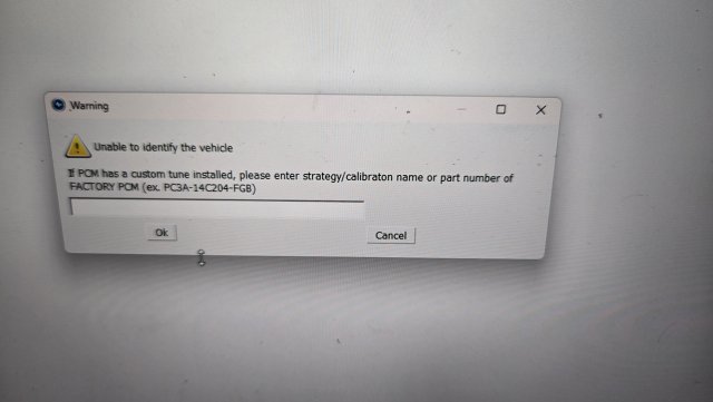

Hey all. New here. So I used forscan on my '24 GT with no issues. Just tried hooking up to the new '25 explorer, and it's saying has a custom tune on PCM and to enter code. What am I missing here? It recognized my GT right away.
Do I need a different plug for some reason?

Ok, checked and have the latest version. This is the error I'm receiving with regards to the tune. 20250105_115707.jpg

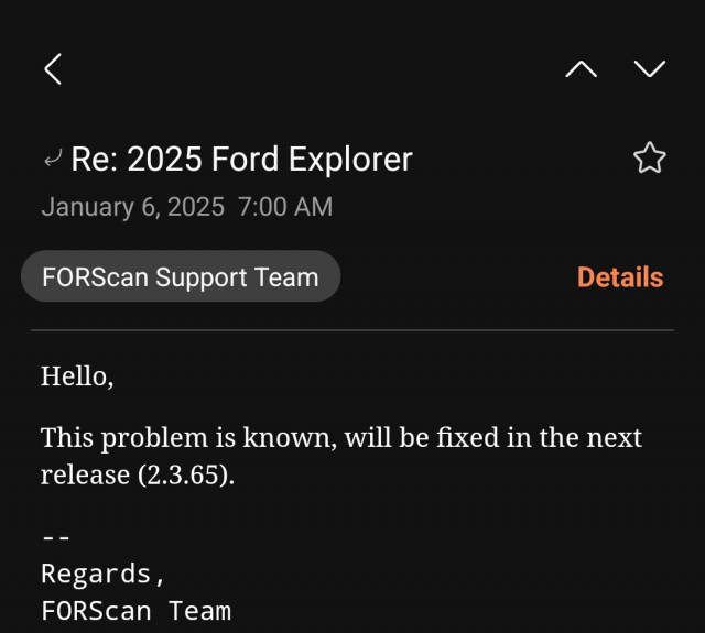

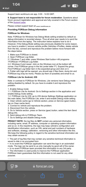

You’ll need to contact Forscan. I had this issue. I emailed them my VIN and debug logs within a few hours they sent me a beta version of Forscan.

Thread Starter #68
yup what he said
we did the simple stuff
now do step 2 (y)
they are pretty quick on a turnaround
let us know the outcome
