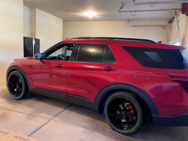

Love our 22’s. Went 22 when I found out the aviator runs them. The wider wheel makes the stance much better I think too.
What size tires are you running in this pic?

Im running 305-35-22 tires no issues ride is great. Putting Steeda drop springs on as I type this.

Start with picking a wheel width...then you can figure offset from there for how you want the wheel to fit the car...further in or out. For OD stay at 30.7” max.
I run a 30.4” tall 305/35 on a 22x10.5 at +30 offset. This is as far as you can push a wheel out and be flush with the fender...and it’s IMHO the perfect fit for these especially with a drop. View attachment 3977
