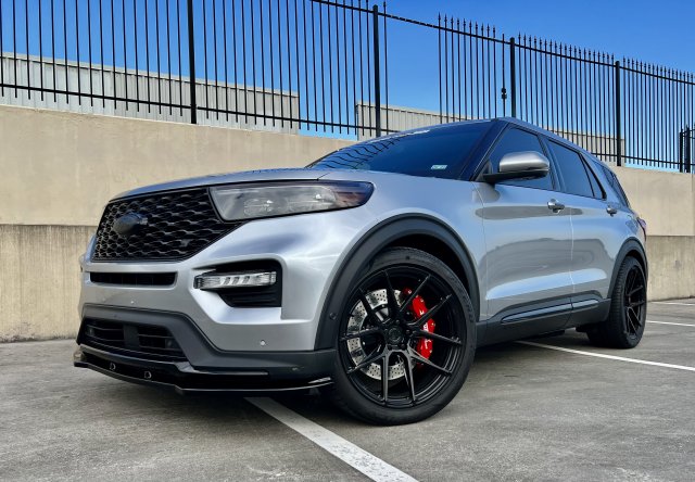

Start with picking a wheel width...then you can figure offset from there for how you want the wheel to fit the car...further in or out. For OD stay at 30.7” max.
I run a 30.4” tall 305/35 on a 22x10.5 at +30 offset. This is as far as you can push a wheel out and be flush with the fender...and it’s IMHO the perfect fit for these especially with a drop. View attachment 3977
Unbroken, I really appreciate your knowledgeable responses. Your wheel set up looks great. Have you noticed any impact to handling or other performance vs the stock set up? Also, could you please let me know what exact wheels those are?
5,011
5,997
#70
Nothing but “pro’s”
Wider stance, more rubber on the road and 60ish lbs lighter than stock. There’s no downside….virtually everything was improved. Mine are BC Forged EH181
22x10.5 +30 offset.
it’s now on 315/35/22’s. 89DC8C3C-3949-45ED-A7EA-7AA92D53E27A.jpeg

Nothing but “pro’s”
22x10.5 +30 offset.
it’s now on 315/35/22’s. View attachment 15024
Awesome, thank you very much.

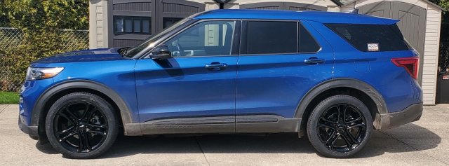

I have 22x9's with a 39mm offset and 285/40/22's. I chose that size because they are exactly 31" tall just like the stock 255/55/20's that came on my ST. 20220420_152445.jpg

I have 22x9's with a 39mm offset and 285/40/22's. I chose that size because they are exactly 31" tall just like the stock 255/55/20's that came on my ST. View attachment 16270
That looks good. I'll probably go with that. I assume no rubbing?
I Bleed Ford Blue
792
553
23 Rapid Red Explorer ST
#79
nope, no rubbing at all. I also had 1.25 F and 1.5 R wheel spacers on it. look up my build thread, there are pics with how much poke I got with these wheels and spacers.
