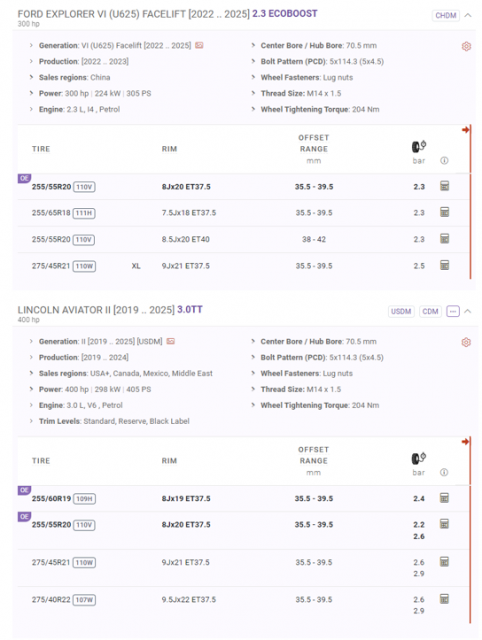

Anyone know if fitment is the same on the Aviator vs Explorer ST?
1,205
602
Welcome to the forum.
Fitment looks to be the same, see below. Do some measurements or talk to a wheel manufacture to make sure.
