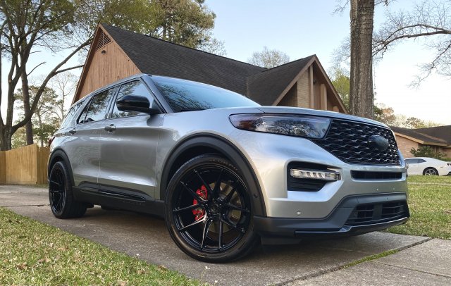

11’s are pretty easy out back but if you want them tucked under the fender it’s too much up front IMHO. Depending on the tire used you could get into some rubbing on the struts. 10.5 with a +30-35 offset is perfect for the front.
If you try to cram 11’s under there your offset and tire selection better be perfect.

Yes it’s lowered on H&R springs. These are kinda similar to the FR2 but far from identical. They’re also forged vs cast.
4,572
5,346
I do a lot of wheel measurement for people here and FB...I think you could pull off an 11 at +30 with a 305/35. A 315/35 would be super close. Either one is gonna stick out past the fender a bit up front and I’m positive the 315 would rub the fender liner when turning. Moving the wheel in further would be super close to the strut on top with a 305...I’m not sure it’ll clear on a 315. With my wheels which are dead flush with the fenders the tire is already close to the strut. I’d have to get under mine and do some measurements before I’d say for sure it’ll fit. It’s just stupid tight with the struts.

Got you. I think I’m gonna go with a 10.5. I will have to change to a different wheel. I’m also looking at Brixton Forged wheels. I just want that look for the wheel. I don’t know a lot about wheels and tires and offsets. Yours looks great btw.

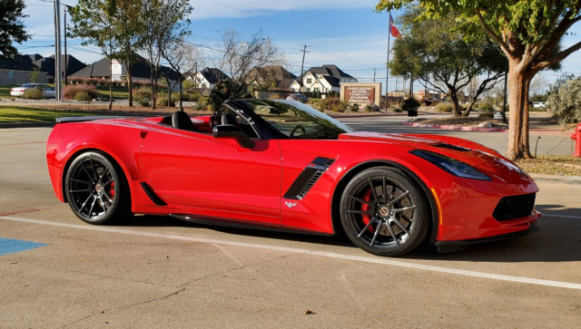

I have Brixton Forged M53s on my '17 Z06. I think they look really nice but for a set of 4 wheels they may be around $6,000
My car is one of their featured projects in their gallery.
