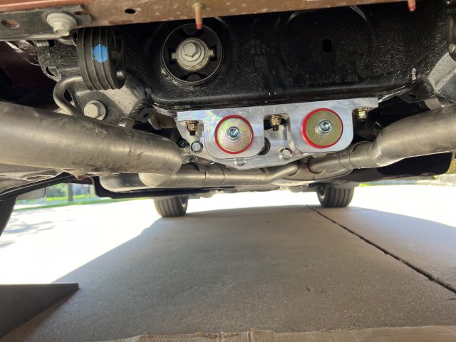

After spending time researching the dreaded differential bolts, one of the next mods I did was the Steeda differential brace. Turned out to be much easier than I thought, and the solid feel of the brace really inspires confidence in the solution.

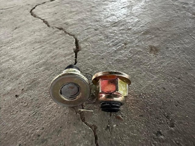

Keep a close eye on the mounting hardware. They’ve been snapping left and right.
Thanks for the heads up. Is it the black threaded rods into the subframe?
Wow. That is crazy.
If the brace is a stiffness add, and the bolts are not garbage - the diff has way more stress than Ford admits.
Also ID-Soeed brace hasn’t had this problem and it is designed very similar to the Steeds one. Has to be something wrong with those bolts.

Wow. That is crazy.
Here’s my opinion…take it as you will.
The oem bushings allow the diff to move but that’s not abnormal or really detrimental. The Steeda brace with 2 bushings (I don’t know what durometer) firms up the rear but the front rubber bushings still allow pinion rise on hard acceleration moving all the stress to the diff brace. If the bushings are too hard…the mounting hardware takes a beating and you wind up with this…some folks have said within 2 weeks. Steeda says they’ve revised the hardware but a few have still said they’re snapping studs. Steeda will also sell you their poly bushing inserts for the front to lock the diff down even further.
I honestly just don’t think it’s necessary…but Steeda sells plenty of parts so others agree with them. I personally think the ID Speed brace that was designed to work with the oem bushings to mimic the oem 4 bolt diff is the better design. The fact that it’s been out a lot longer and had zero failures would support that opinion.
