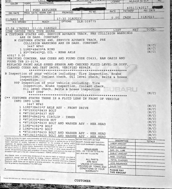

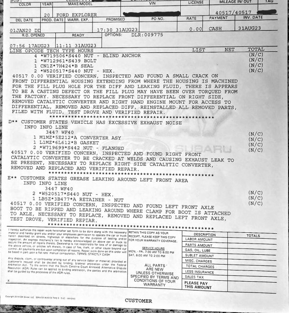

Just as Hbalek said it does fall under the basic 60k basic powertrain warranty. As you see in my receipt from the Ford dealership Service. They fixed my CATALYTIC Converter, Axle boot, Differential, and front axle speed sensor. And was given a loaner. All at no charge.
Now That's what I call customer satisfaction. Keeping the consumer happy. Ford standing by there work
Thank you to everyone who replied to my post. They couldn't finish the diagnostic today and will continue tomorrow. Dealership said they would buyback for 36500. It would cover what I owe but basically I would break even. If it's covered and I can get a loaner I'd rather go that route for now.
Dealership confirmed that all the 2023 ST Explorers are on the lot and can't be sold due to an open recall on their 360 rear camera. The sales consultant that was helping me even said my explorer has been in the service department for almost half the time I've had it. Of course there is nothing comparable on the lot and downgrading doesn't feel right. I love my ST I just hate the problems.
I'm going to bring this info to them tomorrow and push for a loaner. You are all awesome, glad I found this forum.
