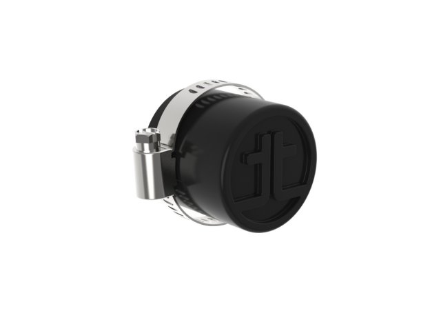

The only thing to note is you’ll have to cap the BOV connection on the drivers’ side intake tube. I used a 1 1/8” chair leg cap temporarily until my Whoosh Motorsports silicone cap arrived today and I swapped it out (secured with a hose clamp).

You’re probably right, but for a few bucks more I opted for the silicone cap intended for the purpose. I would hate to have the plastic chair tips crack after a few northeast winter/summer extreme cold and heat cycles.

Last week I reached out to aFe power told them of the cap needed on 2022 STs. They asked for my receipt with the estimated shipped date 5/1.
Today I received a package from aFe Takeda Cold Air Intake System Spare Parts | aFe POWER
I like it.
