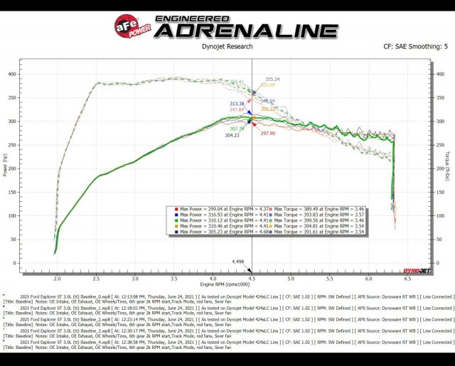

Who did the dyno test and were you there? What changed between runs? Need to know what the stock airbox does.

Why does every "note" say OE intake? I'd have to say all of those runs are within the realm of statistical differences between runs and don't show anything substantive. I'm not suggesting that the intake might not allow more airflow, but that dyno doesn't show anything. Any real changes should be visible in the horsepower numbers over say 4k rpm due to mass flow. And I don't see that even if the note section is wrong.

It was late last night when I read this Dyno sheet and it doesn't zoom well with my old eyes. I thought for sure I was reading it wrong or there must be a second one coming. I was really waiting for someone else to see what I was seeing.
That said, I think it has been shown time and again that Ford does a pretty good job of making a CAI that is able to support what a stock engine needs.

I pulled this off the website. I guess I put the baseline dyno sheet up. Unfortunately I can't find the one they sent me along with the baseline.
