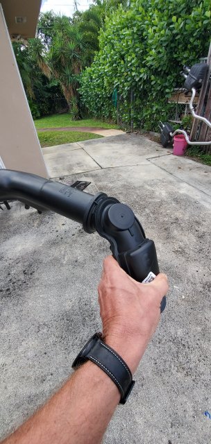

Some issues I found.
A) My build doesnt have a BOV to connect to the new charge pipe, no place for it on stock charge pipe either. Just plugged the connection on the new charge pipe, no biggie.

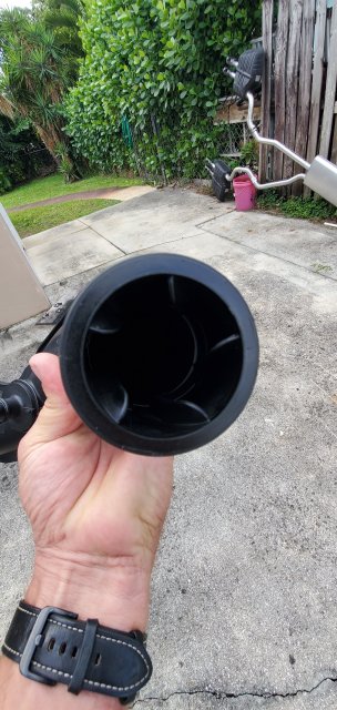

B) There is a IGV insert in the pass side pipe, which was easily removed and reinstalled. On the driver side, the IGV vanes are built into the charge pipe. Just left it out, no issues.
C) As far as the turbo connections on the drivers side, just take it off from turbo, didnt worry about the clamp just forward of it, not required for reinstallation.
LOVE the sound!!
THANK YOU for the new PCV tube!

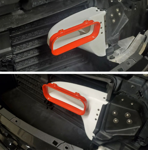

4,961
5,913
I’ll bet anyone here $100 if they do proper logging with that thing there will be zero difference. None.
That opening is quite a bit smaller than the opening that’s already there…sealed in a high pressure zone. Facing a smaller scoop forward will only scoop money out of your wallet. Pushing that red seal up behind the grille will let even less air in given the shape of the grille openings if that’s their intent. 973F7CCC-E0C7-439C-A820-941D44A970FF.jpeg
