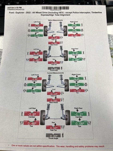

Didn’t want to start a new thread for a common question/issue, so I’ll add onto this one.
Had the ST find a rather nasty hole in the pavement which ended up collapsing part of the Steeda adjustable rear toe link on the passenger side. Got a replacement part from Steeda and had the dealer install it. Now they say they can’t get the camber alignment in spec on the drivers side. They are saying that they need to “modify“ that side to allow it to come back into spec. My gut reaction is that they have no clue how to align the camber properly and have forwarded the link to the procedure that @Cajun Heat has provided on more than one occasion. Since there was obviously some serious lateral movement, is there a chance that something else has gotten damaged and is being overlooked by the dealer or does this sound like an inexperienced service person missing the obvious?

I'd be looking for what else got bent. Even heavy steering knuckles can get tweaked.
That’s what worries me. They say they don’t see anything else damaged but it took a lot of force to bend that part. After sending the link, the dealer says the alignment guy has 30 years of experience. So I would assume (yes, I know what happens when one assumes) that they know what they are doing. Just find it strange that the side they can’t bring back into alignment is the side away from the damage.

I would suggest jacking up the rear end on stands, taking the wheels off and comparing sides. Some parts like the upper control arm is curved and could have easily been bent on impact--and not obvious by looking at it. If you can assume the passenger side is normal, maybe you can compare, including taking measurements.

#20
Thanks for the ideas. Hadn’t thought about it but the sway bar could be the culprit.
