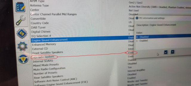

Turn on:
BCM : Fog Light with High Beam.
ACM : Enable HD radio.
Turn off:
ACM : FENG

Turn on:
Turn off:
ACM : FENG
Oooh didn't know you had to turn on HD Radio, will do that as well.
