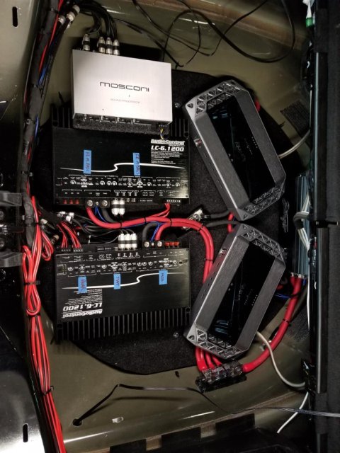

I’ll be spending the next couple of months fine tuning my list and working out the install details but right now my list is:
Focal Utopia M tweeter and midrange in custom a-pillars.
Illusion Audio Carbon C8 midbass in the doors.
Illusion Carbon C12XL built into the same side as the oem sub.
Mosconi Pro 1/10 and a pair of 4/10 amps.
Mosconi Aerospace 8to12 DSP with remote RCD controller.
Amps and processing will be a false floor build above the spare tire.
Still a lot of things to work out and finalize. My goal is to keep everything under 200lbs installed. I bought this ST with the goal of competing in MECA SQL again...looks like Modified class with the pillar build.

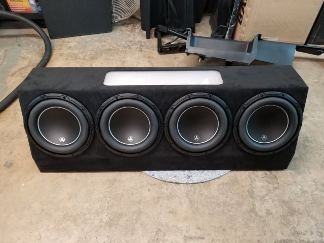

My set-up:
NAVTV ZEN-A2B...................................................RETAIL $549.99 YOUR PRICE $500.00 ( Factory audio interface )
FOCAL EC165KX3................................................MAP PRICE $2299.99 YOUR PRICE $1889.00 ( Front three ways running full active )
40' JL AUDIO 0 GAUGE CABLE PACKAGE........ YOUR PRICE $400.00 ( Super hi quality 100% OFC copper wire for both power & ground from battery )
CABLES FOR "BIG 3" UPGRADE........................YOUR PRICE $100.00 ( 100% OFC copper wire for Alternator to battery, engine block to chassis & battery ground to chassis )
MOSCONI 6TO8PRO DSP.....................................MAP PRICE $799.99 YOUR PRICE $689.00 ( 6 channel in / 8 channel out full suite DSP )
MOSCONI RCMINI.................................................MAP PRICE $249.99 YOUR PRICE $219.00 ( DSP controller / bass knob / preset selector )
STINGER ROADKILL EXTREME (CASE).............MAP PRICE $195.00 YOUR PRICE $179.00 ( 9 sheets is 36 SQ. Feet / 18'' X 36" Per Sheet )
STINGER SERIES 8000 PREAMP CABLES........MAP PRICE $451.00 YOUR PRICE $320.00 ( 4 Y-Adapters, 5-3' 2 channel RCA from DSP to amps )
MATERIALS..........................................................YOUR PRICE $150.00 ( Wood, mounting steel, fabric,ring terminals.....)
JL AUDIO 10W3V.3-4 (4).......................................MAP PRICE $1199.96 YOUR PRICE $1035.00
** O R **
JL AUDIO 10W6V.3-D4 (4)....................................MAP PRICE $2399.96 YOUR PRICE $1990.00
_____________________________________________________________________________________________________________________________________________
FOCAL PS165V1.................MAP PRICE $519.99 YOUR PRICE $419.00 ( Rear door 6.5'' woofer w. 1'' tweeter in factory locations )
