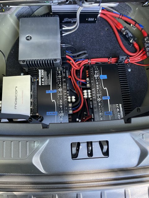

Did you use the wire from the factory speakers? Im installing a similar build. Where the amp is at? to instal the Zen Nav
The amp is attached to the oem sub enclosure. The A2B plugs in there.
And no way I’d ever use the tiny oem speaker wire. I like overkill…I run 12 gauge to my front stage and 8 gauge to the sub.

im not sure about the factory wire but I can find out, the amps are in the spare tire compartment

Do you have the premium system? If yes you can't remove the amp due to the Can Bus. Pretty sure you would need a NavTV Zen A2B interface and plug it into the factory radio. There are many options and compact sub amps like the Audio Control ACM1.300, it gives you 300 watts rms @ 2ohms and oy measures 9-1/2"W x 1-13/16"H x 3-9/16"D, problem with the existing location is you may not have enough air space the subwoofer would require. Look into a shallow mounted sub like the JL Audio 10TW series, they only need .5 a cubic foot of airspace to sound good. Good luck!!!
I guess that's why I'm having so many issues, I was plugging on the opposite side of the sub enclosure. Do you have a picture of where did you plug your a2b?
You completely remove the factory unit from the equation. The Zen takes all of the plugs and you connect your amps from there.
