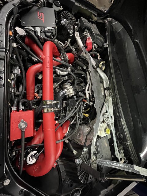

Yea mine I can hear now but before I cut the hood I’d have to roll the window down to make sure the Turbosmart valve was even working.
your ST is the hardest I’ve seen, period. That raw finish under the hood to mimic the silver paint puts you in GOAT status

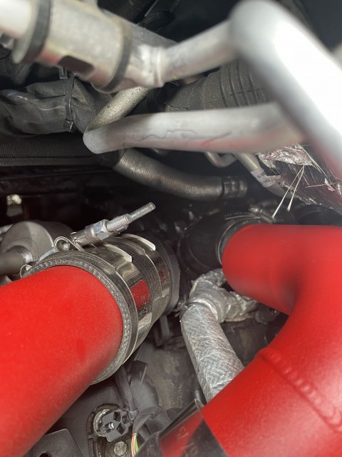

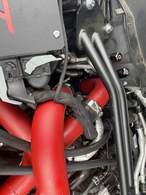

Ahhh yes the driver side turbo, that’s the first piece that needs to go on then the cai. You need to find T handle 7mm/8mm/9mm/10mm tool. Mine is from my Armma RC car.. allows you to loosen the clamps and they are very compact. I pulled off the coupling that came on turbo and secured it to charge pipe the attached to turbo.

Driver side was cake, it’s the passenger side that I didn’t get along with lol
Mac, did you get an extra clamp piece that was smaller than the rest? What did you use it for?
