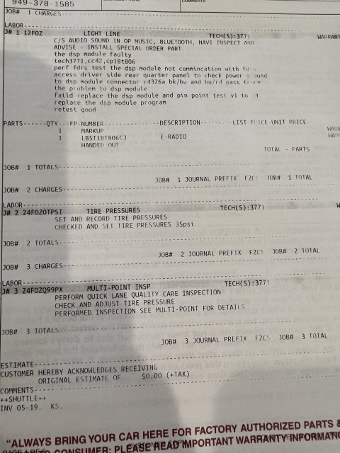

Has anyone experienced radio, gps and all display operational but no sound. Dealer says update of system was required. Happened twice. And input?????
I just got back from the dealer because I was experiencing the same issue, and yes, I tried the “soft” reset and master reset. Apparently a module burned out and needs a replacement. Once they get the part (Mon/Tues), I’ll go back prob Fri to get it replaced. I’ll take a pic of the actual part they replaced for reference.
So this module replaced by the Ford dealer fixed my “no sound/audio” issue.

Good that you’re still under warranty. Wondering what‘s the failure rate for the module and out of pocket cost to replace. Was it a low cost easy remove and replace or something of high level difficulty and cost? If anyone have an idea.

can you please confirm the part number for the module? I have the same issue, and the dealership wants $900 to replace it. I found some on eBay for $400 and I have the ability to replace it myself. Just want to make sure I’m get the correct part with NAV and everything.

Hello,
thank you
Doug
I believe the part# is listed in the pic…I think it’s the “LB5T18……”
