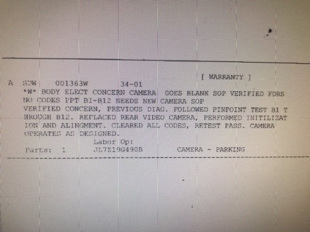

Dealer replaced camera yesterday. Drove it for a couple hrs. No problems! 4332EC5D-FE8D-4B54-8129-90C5B9C53F5D.jpeg

Did you by chance show them the work order I posted above?
