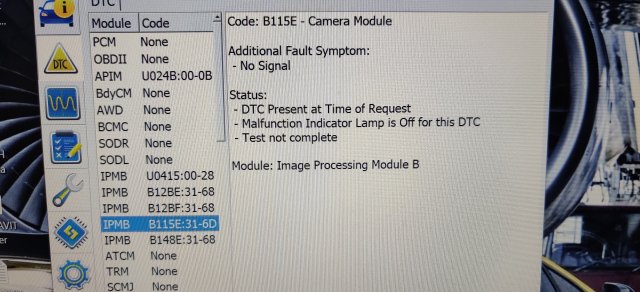

Hey
There wouldn't be a manual with that would there? I mean Plug in Forscan? What?
Reset DTC? associated with that fault? What?
Dtc caused by module that controls those cameras.
Google Forscan, it do all kind of advance stuff.
Awesome tool .

I'm sorry, I'm not sure what your screen shot is telling me nor how to go about fixing the blue screen. Could you maybe elaborate more on solving the problem?
Thanks
40
Dallas, TX, USA
#48
Thanks
It's showing dtcs associated with camera module faults.
Either use Forscan or dealer scan tool, to reset them.
That has worked for me.
