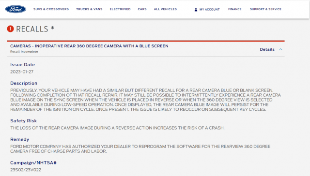

My Ford pass mobile app doesn’t show the notice. I logged into ford.com and went to my account and that’s where it shows the recall.

My 2020 didn't have the issue until about 10,000 miles or so or about 11 months. Then it got worse and worse. Then they updated the software which didn't fix it. So they replaced the camera about a year ago. It's been better but still get the blue screen for a second or 2. Before it was blue until restart. I just logged into Ford account and here it is:

Just got my recall done Friday on my 21’ ST. Let’s hope update fixes it for good. Receipt states:
RECALL BACKUP CAMERA BLUE SCREENCAMPAIGN/NHTSA#
23S02/23V022
PERFORMED FSA 23S02
