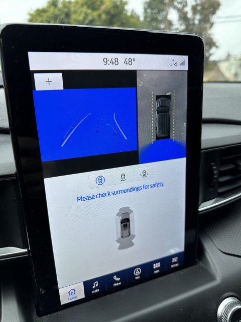

It lasted 8 days. First the automated backup assist error popped up yesterday. Now the entire screen camera viewer is blue as if all cameras are down rather than just the backup camera.

I had the latest recall update done on Feb 9 after 3 previous attempts to fix it. I have not had the recall notice as of yet but the dealer called me to advise they had an update for the latest recall.
I am still having issues since the latest recall repair.
Rear brake assist error message and the top portion of the screen is now all grey vs a blue area shown in the rear camera view.
I have not taken it back yet.
Lak
Los Angeles
Didn’t fix the issue for me either. Had the recall done about 2 weeks ago. I still get the blue screen regularly.
Just had it again today.
