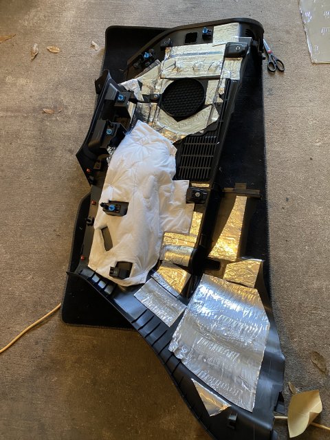

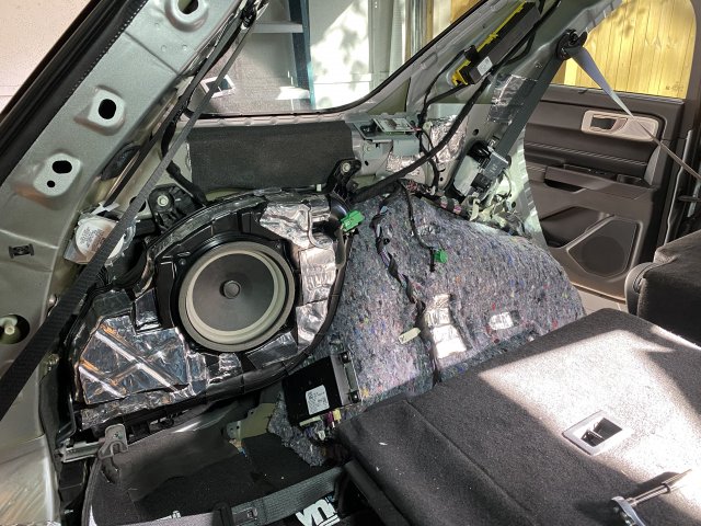

I was working on my sound deadener project today and pulled the sub enclosure out so I figured I would slap some scrap CLD on it to see if it would improve things. The oem plastic enclosure is thin and sounds like an empty beer can when you tap on it. Deadening it, along with the rest of the stuff I’ve done with interior panel treatments, doors etc has actually made a noticeable improvement. I’m still gonna yank it all out but it’s at least a little better now. I can actually get some impact out of it now.

Gutsy work there, Unbroken! Is that a paper cone or polypropylene?
