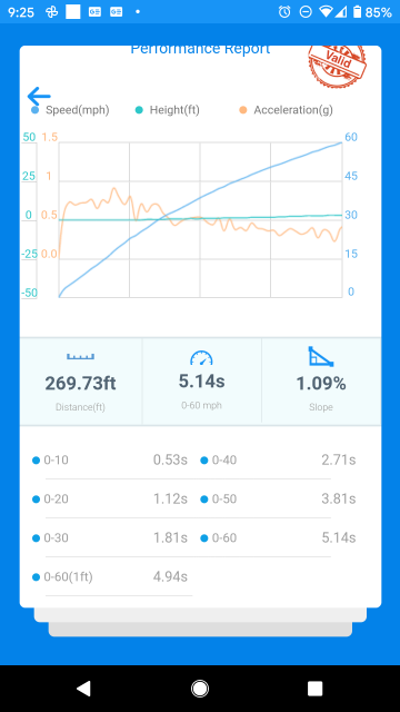

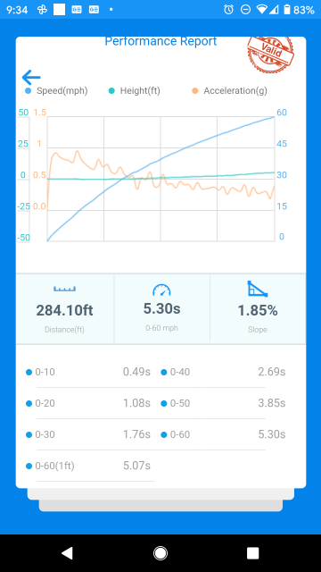

Results from the Canned 91 octane tune from SCT, loaded onto my X4 that I still had from my previous Ex Sport. Baseline on Friday was a 5.72 with a DA of 4328 ft.
Slightly better DA today at 3021 ft.
0-60 was 5.14 (4.94 with a 1 ft rollout) So it was close to a 6/10ths improvement with the canned tune for my vehicle.
I did get some weird behaviour, it spun the tires the first time I got it up on the brake so I aborted that run and then tried to launch it with a bit less throttle and the traction control light flashed, even though I had it turned off.
I then did a backup run less than a minute later and it had a better 0-30 time but it fell off slightly from heatsoak, 5.30.
Not bad for just loading a canned tune from a tuner I had sitting on my shelf.
