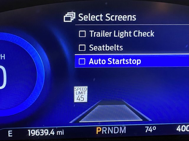

On the Livernois, it is a dash option that you can check or uncheck. 80A77206-CD5F-4E4F-84B4-3CCCF06C5BED.jpeg

On the Livernois, it is a dash option that you can check or uncheck. View attachment 2168
Hahaha! That just displays whether it is doing it or not. It has ZERO effect on the operation of it.
OK thanks. I thought that was an enable/disable toggle. I guess they deactivate it in the tune.
