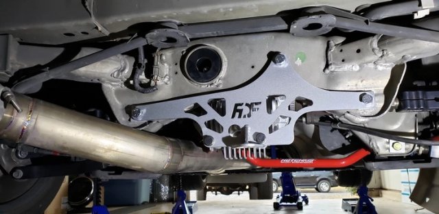

You can't do that. It's missing the entire differential mount that the bolt is supposed to insert into. No way to add that without some serious fabrication. Just compare the pics of the one bolt subframe vs. the two bolt and you'll see what I mean.

If that's the "answer", someone asked the wrong question. FenFab does some trick work, but this.... Think about the differential movement under torque, then look at the design of this "brace".

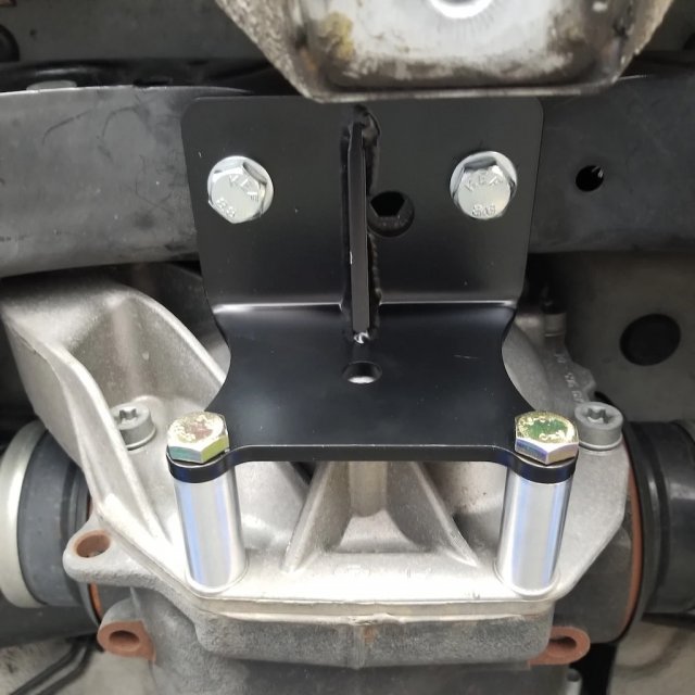

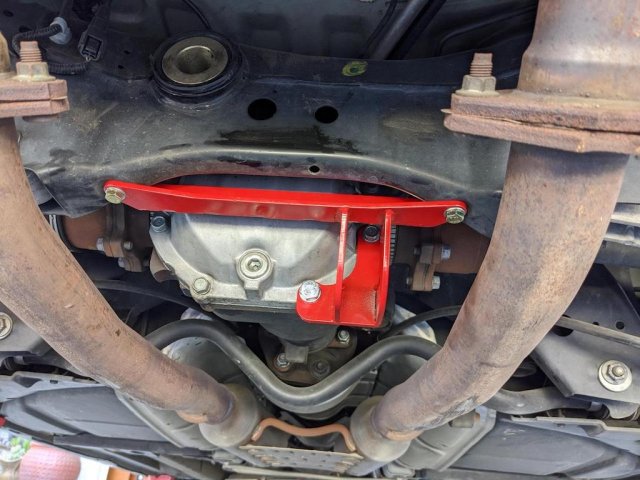

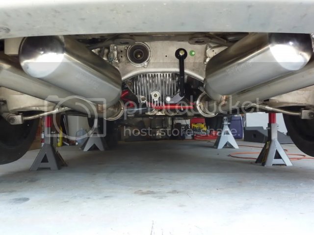

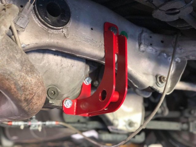

Not so sure. If you look at some of the aftermarket rear differential braces for other vehicles with the same single, off-axis rear diff mount, some are just a rigid brace bolting the differential to the subframe.
BMW F series:

350/370Z:

The bolts in the rear of the differential are to limit travel of the diff in the Z plane- up and down and may have some stabilization in the left to right motion. Under torque, as in a launch, the front of the differential where it connects to the driveshaft will move upwards, trying to rotate along the halfshaft/axle centerline in the opposite direction of the wheels. The rear of the differential will of course rotate downward.
Please point out to me how that "brace" will limit the rotation of the differential as the mount tries to counter the downward force. The only thing stopping it is the contact area of the two diff cover bolts- which are slotted!!! If that wasn't enough, the "isolator" (red part) should be used in compression and yet it would appear it's expected to work in tension? If this was designed to limit travel while traveling in reverse, then it' might have a chance. A simple pinion snubber would probably be a better alternative.

Under torque, the differential not only wants to tip the pinion upward but also wants to wind the diff clockwise. The red composite material would be compressed under torque if only one plane is considered. This axis seems to be what has been taken into consideration with this design, it does not seem to address the larger issue. Discounting the pinion wanting to move upward and dealing with only the rotational plane (you can't have one without the other) this design would work. How well? I have no idea.

Any "clockwise" motion should be primarily handled by the front two mounts.
