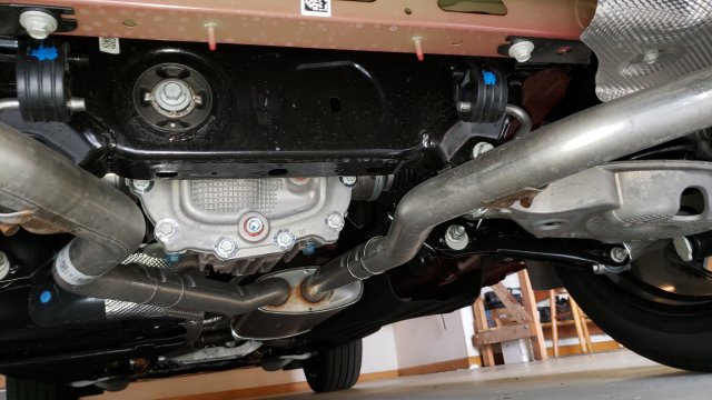

MY 22; Build date 02/22. Just picked it upSaturday
MattJ716 was my salesman :)
Just looked underneath; only one bolt. Hopefully no issues in the long run.

I just ordered the correct subframe for insurance.
ARC
326
106
Oak Lawn, IL, USA
2022 ST Black
#60
Damn what did that cost??
I have a 22 and also have one bolt rear sub...
