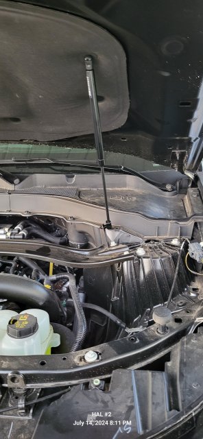

I did the MRT struts and though they are no-drill, you do have to cut a little of the plastic.
I forget the brand..
But no cutting. You use an exsisting trim button hole for hood attach point
Got em off amazon
Got em off amazon
Very nice. Looks like a 2 min install as well.

#26
maybe 15, i found if you remove the under hood blanket first...it makes it easy to get to the holes to attach the nut plate
after i struggled with the drivers side for a few minutes, i said screw it and removed the hood blanket, then put it back after i was done
