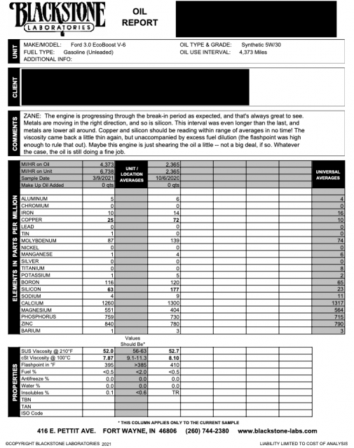

Similar results here. Definitely appears the factory fill is 5W-20.

Interesting that the dealer is either continuing to put in a different fill/blend or this engine is a little rougher on oil than most. I will be doing the next change with Mobil 1 and see what happens (this fill was supposed to be synthetic per Ford). Has Ford resolved their issues with fuel dilution and timing chain stretch at this point? Or is there anything else I can do to help prevent stuff like that? I may just continue to do 4k - 5k changes.

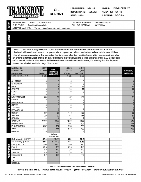

Looks like shear is definitely the culprit rather than dilution.

Magnesium numbers seem to be creeping up...are you using the same oil each change or have you switched? What viscosity are you running?

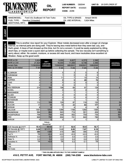

Hmmm. Magnesium continues to creep... But everything else looks good.

Likely caused by a detergent in the oil or in the fuel. Since your report shows little dilution, I'd think the oil might be the cause.
You certainly don't have levels going to the moon and I wouldn't think it's a worry. That one would be easy enough to check. Try a different premium oil before you send in your next sample and see if the levels follow the oil.

Thats my hunch as well. I'm running Amsoil because its supposedly the best performer against oil shear and I was having issues with that in my first few changes.
Been using Amsoil Signature Series since the change at 16,000mi. The change at 11,000 was M1. The two previous were dealer performed supposed "full synthetic" and pre-tune so I was less picky/concerned.
I just passed 26,000 miles and so will be changing out before the end of the month. Should have a new data point sometime in May then. Will go from there. Will be putting on a new air filter at that point too.

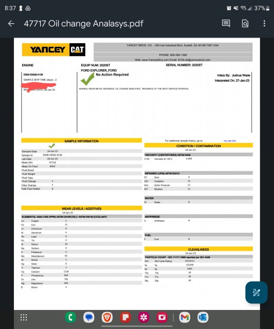

This my Yancey analysis from January.
May get a Blackstone next time. The Yancey kit is free for me. Screenshot_20230404_203720_Drive.jpg
