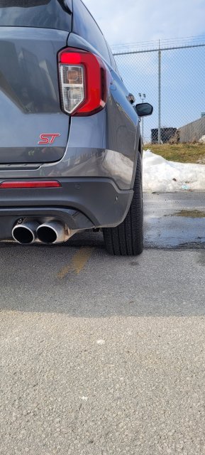

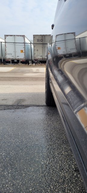

A couple of photos for yall.
Tks. View attachment 10875
The 1.5" spacers on 21" stock rims/tires.
Should the tires be on this angle?
Is this dangerous?
Been driving with them on for a few days and no issues.

The spacers are having ZERO effect on the negative camber people are seeing in that pic. They are just pushing the wheel further outboard so its a little more visible as you have the fender to sight along and give a point of reference. An alignment shop will let you know if you are within spec though--it could just be an optical illusion. You don't appear to have lowering springs so its odd that you would have excess negative camber from the factory.
