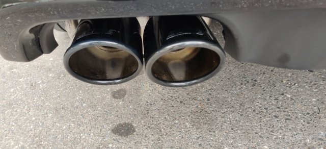

Borla Exhaust Upgrade
KegsBdry
936
421
WashDC
You’re right. The fake sound in the radio sounds good. On the outside the ST sounds like a mini van!
LOL! Exactly why I changed the exhaust the first month. Can't be the only one enjoying that sound!
KegsBdry
936
421
WashDC
Yes, best decision I could have made! Sounds great, looks great. Wanted to go with a carbon-fiber look, but friend talked me into doing the black tipped. I think it looks and sounds a lot better.

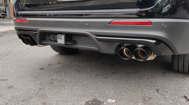

Went to my local shop today. I removed the back 2 resonators and just ran “real” tips to the exit. I left the main muffler and piping intact for now. I like the sound and look. For $300, I think it was worth it. DB0E40E7-049D-47EB-B911-DFEEC2669B13.jpeg

Went to my local shop today. I removed the back 2 resonators and just ran “real” tips to the exit. I left the main muffler and piping intact for now. I like the sound and look. For $300, I think it was worth it. View attachment 648
I'm shocked, that does sound great. Only $300 too!
This goes to show that Ford could have easily made a better vehicle by simply adding better looking/sounding exhaust pipes. Good job!

The shop had a good selection of tips. These are Flowmaster tips. I almost went with a set that was a little more slanted, but settled on these. I was almost going to get larger single tips on each side, but they didn’t look right in the cutouts on the rear valence.

Darn, sorry didn’t pay much attention and threw the boxes away. I was at the shop and I actually held a few different tips up to the explorer while it was on the rack to see what looked good. It’s hard to decide just off pictures unless you see it on the truck.
