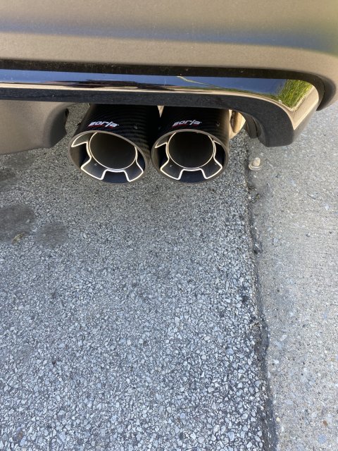

I installed the Borla ATAK with carbon fiber tips and it sounds awesome to me, of course it's hard to replicate a V-8 but.....

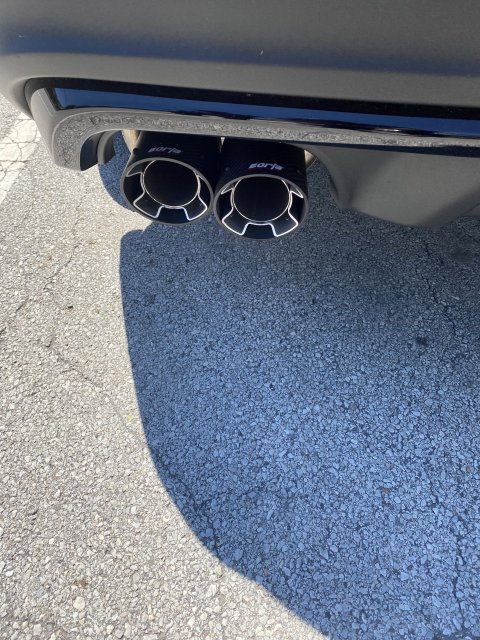

Borla S Type installed and love it. Not to much or to little.
