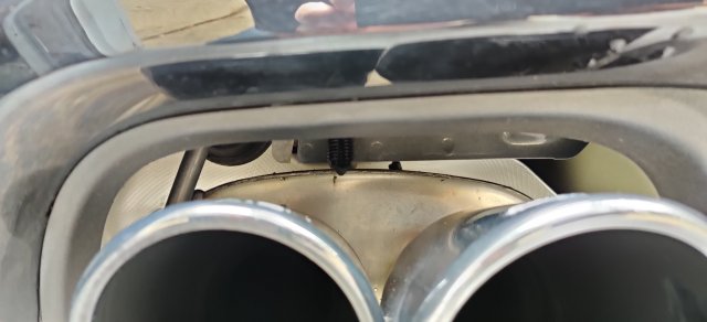

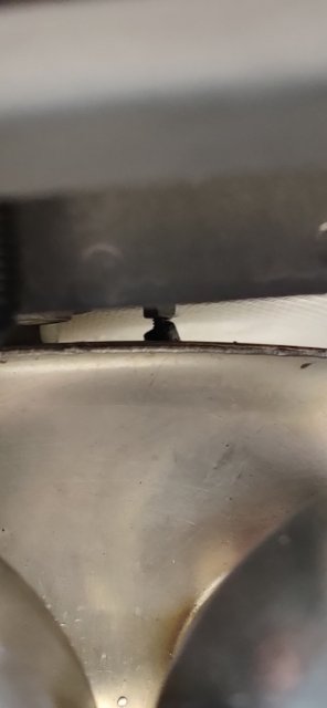

Borla S Type exhaust had a recall on their resonators. After getting the new one in, I started hearing rattling around 1500 rpm.
When getting the ST up on ramps, I noticed a screw was a fraction of an inch away from the top of the mufflers. They only made a noise when I slightly lifted the muffler upward. I put a piece of plastic between the screw and the mufflers. No more noise. ;)
I wanted to share this in case anyone ran into the same problem. Pictures included.
I had the same issue but I just cut the ends of the screw off with a dremel. No more noise.

Just finished the exhaust install. Not bad but Borla should update their instructions. Didn’t realize if the six clamps, two were different and those need to be on the front of the exhaust. The other four are for the middle and back. Other than that, not bad. Did it by myself using two coolers to support the old exhaust when I took it off.
One issue I can’t figure out is that the right rear muffler is hitting a large frame bolt and causing a vibrating noise. I had to slide a piece of cardboard in between until I figure out how to adjust it down away from the bolt. I cut the heat shield bolt which was easy with a dremel.

What was your fix for the frame bolt? I am having a similar problem. I don't want to adjust the pipes down because it looks good where it's at. I was think about placing some heat wrap in between the bolt and the muffler so it isn't metal against metal. Thoughts?
Jshaffer3819
471
Kaiserslautern, Germany
I actually ended up adjusting the mufflers down just a little. It was pretty easy to do and hardly noticeable. No rubbing at all now.
953
639
I had the excess length of the four bolts cut off after the removal of the stock mufflers and before the install of the Borla mufflers. Problem solved.
