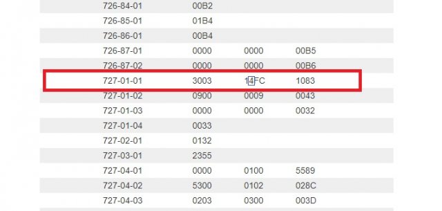

I used FORScan. It's the same code as the F-150 in the APIM "as-built" section. You change the '4' to '0':
