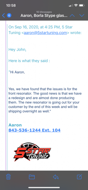

Just an update for y’all. I received an email from 5star on the exhaust and wanted to share it. After I install the new resonator and test it I will post the results.... that is if it stops the fibers or not. Good day guys.
Yea, Borla is sending me new resonators and guarantees that will fix the problem. We shall see.
