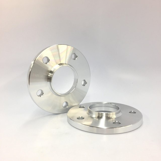

Yes…12mm minimum with stock 21’s which pretty much means 1” bolt on since a 1/2” slip on is too thick.
Confused a little. Could you use some 12mm spacers like these?
1,463
701
No, the studs aren’t long enough
