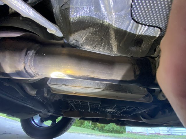

Catalytic converter #3. First 2 replaced due to crack at the weld, passenger and driver side. This one is driver side. This is NOT at a weld, but a fractured pipe. Closest weld is at the very top where a support hanger rod is welded to the top of the cat pipe. 45 years of driving vehicles with CCs and I've replaced more cats in 8 months than the previous 45 years. Good news all covered under warranty, and available. China balloon mystery solved.....pallet of CCs to FOMOCO express delivery

it may be louder, you may smell exhaust in the cabin but you may not. Best way is visual inspection. It's hard to see the welds by the flange. my crack was the weld further down. also the flex sections in the midpipe are prone to rattle then fail. keep an eye on those too.

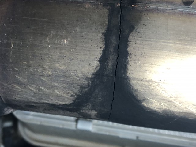

that black soot isn't necessarily a problem. BUT when it's coming from a weld, there is definitely a crack there. Bring it in...
