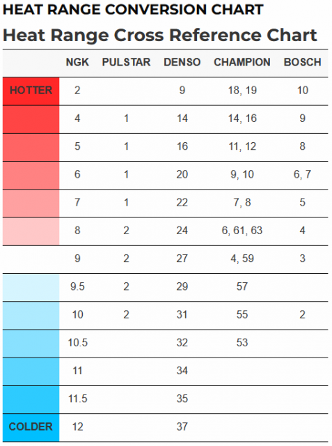

Are the Bosch 96315 the same heat range as OE? Or one cooler? Running e85 here I want to make sure I'm not going cooler. I don't know where the heat range specs are for stock or these are. Anyone else better informed? Thank you.
26
2022 carbonized grey ST
#27
96315 are 1 step colder plugs
