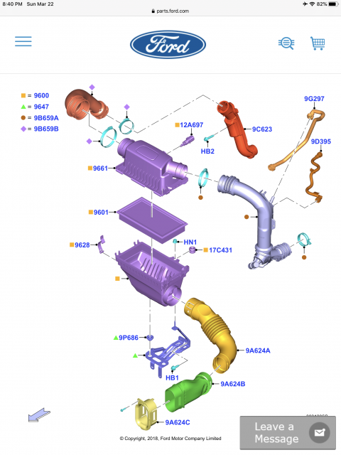

A CAI on this engine not only will be complicated, but as already mentioned, probably not worth much as far as gains go.
You can find the diagrams right on the Ford Parts site easily.
Intake, to the turbochargers:
From the turbochargers, through the intercooler, and back to the TB:

Thank you very much ! The one thing i can't figure out is the top of the air box having 2 different size outlets depending on which side they exit . Left side outlet pipe is larger than the right side outlet pipe .
356
296
The midwest
#31
On the EcoBoost platform and most other turbo platforms when people are referring to a cold air intake they're only talking about the part leading up to the inlet of the turbo not the entire system. Charge piping and intercoolers are a totally different ball game.
Correct. I only included the other diagram as a reference to show where all the piping fit. On my previous 3.5L, it was easy since there was one inlet leading to a single outlet - definitely different here.
Yes, noticed that too. Not sure of the rationale, maybe just packaging?
Edit: Dug this picture off the web since I was too lazy to pull my cover off. I'd guess that larger opening on the passenger side has to do with the first tight bend. The engineers probably figured it was necessary to equalize flow, but that's just my guess. The part number is unique to 2020, so there's definitely a reason behind it. Gets even more interesting when you look at the cover from the inside.
