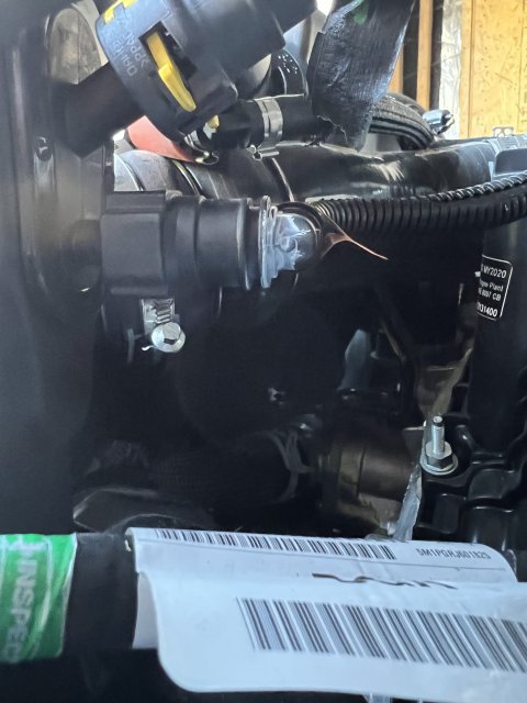

so the tab on the sensor needs to be pointing towards the air filter.
144
74
San Diego

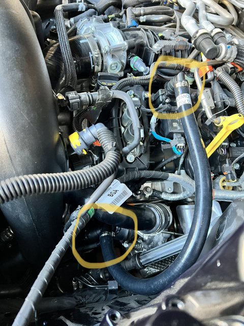

320F8E45-6C56-4C4F-9D9E-702C9FC2531C.jpeg also check the connections on the passenger side tubing.
144
74
San Diego
On the driver’s side make sure to check your connections.
144
74
San Diego

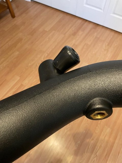

down in this area, make sure they capped the intake since we didn’t get BOVs from the factory. I just used a 1” chair end tip and clamped it in place for now.
144
74
San Diego

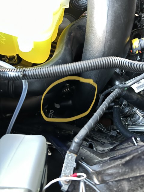

Lastly make sure the connection to the driver’s side turbo is on good.

Bummer, by chance, did they cap off the bottom of the intake on the driver’s side tube? Like this or something similar?

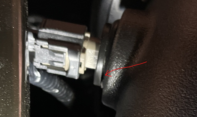

This is the passenger one
Zooming into your pic of the passenger tube... I think the rubber grommet is not seated properly. It looks like it is on at the top but at the bottom it appears to be pushed in.
1,602
1,167
#36
Nice catch. I agree it looks like that grommet might be leaking.
