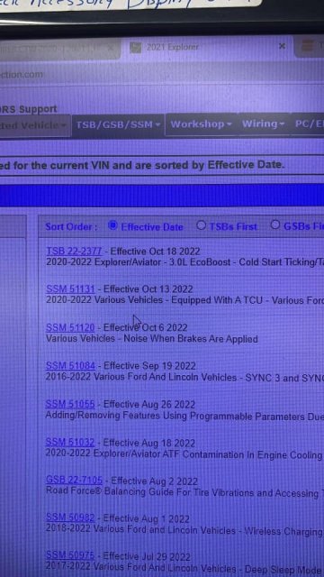

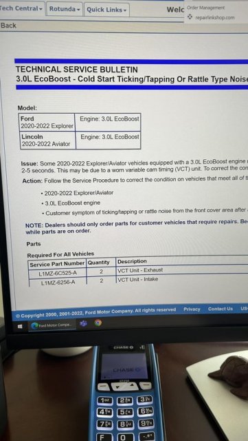

Just see this on a Facebook post about the 3.0L Ecoboost engine.

Wow, I was hoping they would have this cam phaser issue worked out by now...

are you able to provide the TSB #? Can't see it in the pic. Thanks in advance!
From another post. TSB-22-2377

Thanks!

Anyone have a link to the complete TSB?
