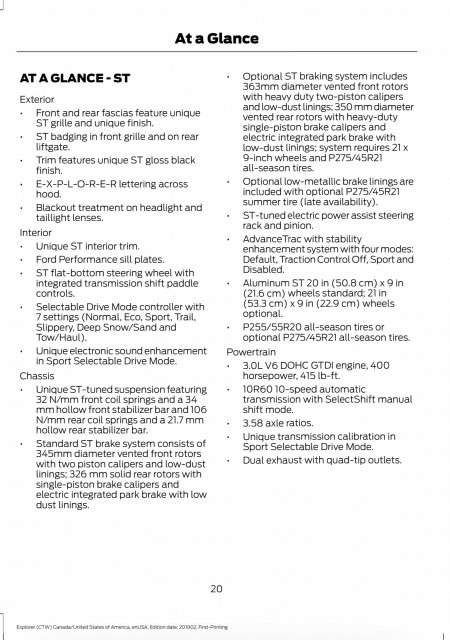

Only blue? :cry: Does anyone know the specs of our factory bars?
It’s right in the owners manual…
