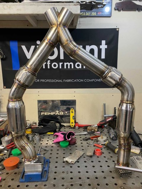

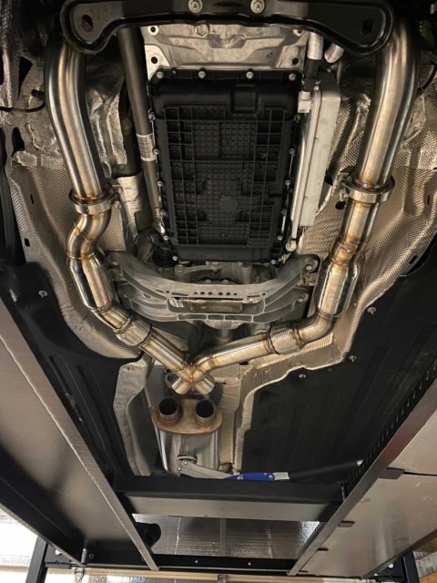

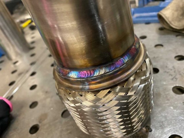

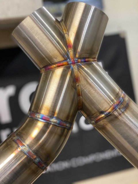

Another day of progress! Next up magnaflow mid muffler (internal x pipe design) then out to two rear small mufflers. We ordered both vibrant and magnaflow and will see which works better with the design, they are slightly different dimensions.

I’m not sure how anyone could afford this technician’s/artist’s time. He’s phenomenal.

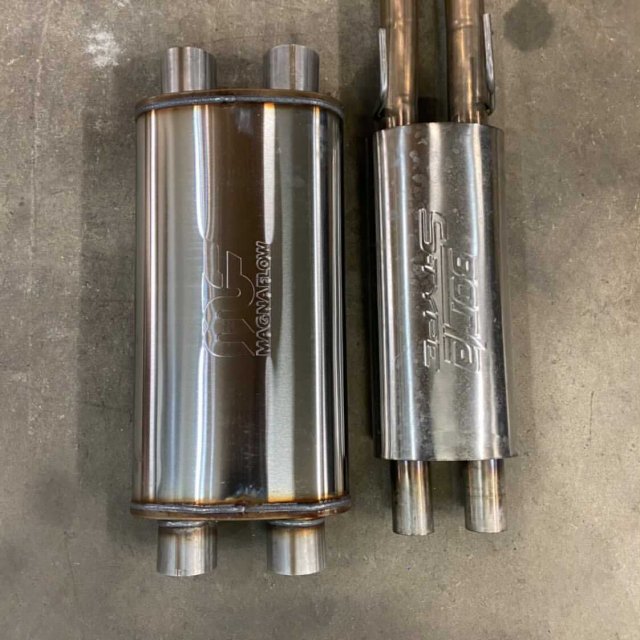

Mid muffler comparison vs Borla - purposely went for a bigger Magnaflow mid muffler with internal x design so we could go smaller on the rear mufflers. Excited to be running dual x pipes - can’t wait to see sound it produces.

Rear muffler options compared to Borla. Bigger is vibrant option and smaller is Magnaflow option (both smallest options in oval shape). Will see how each works fitment wise.

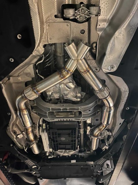

Mid muffler lining up...

Which big Magnaflow is that? The big 5x11 PN 12599 is the only one with an actual X inside. The smaller 5x8 is a long internal Y...you definitely don’t want that one.
I figure you got the right one...kinda posting this for reference for others.
Exactly - Magnaflow PN 12599 is the mid muffler I have shown in the pics above.
The resonators are Vibrant PN 1794.
Will post the rear mufflers details once we decide on which to go with.
