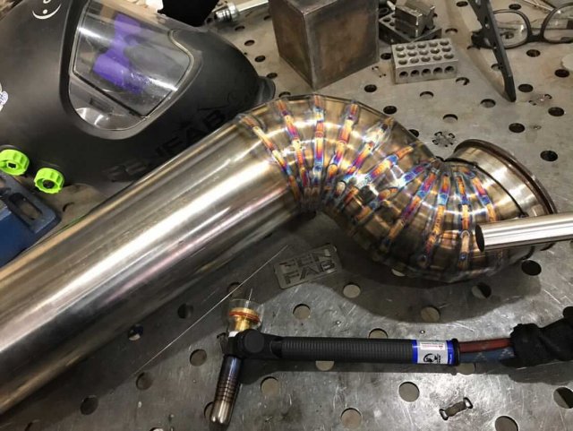

Piping to mid muffler done, now have to weld. Check out the pie cuts on the right, going to look awesome welded. Some examples post welding of others he’s done...

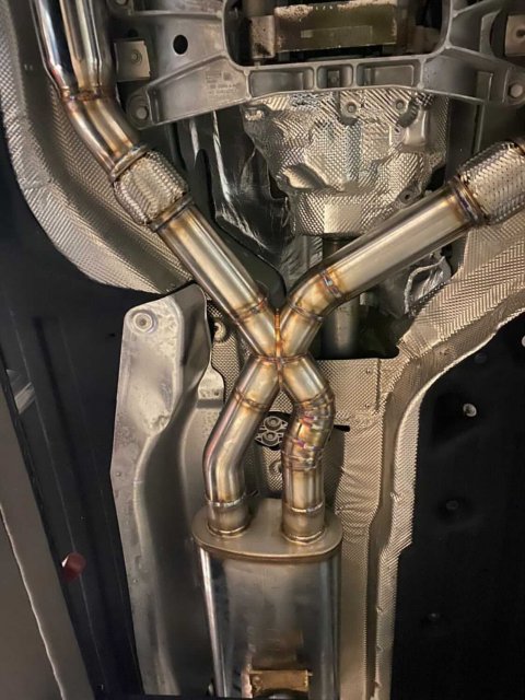

I love the quality of the exhaust you are building and I definitely think bigger is better. I have what may be a stupid question. Why have a cross pipe (X) connection just up stream of the mid muffler and a cross connection in the muffler too?

Honestly mostly to just be unique and experiment. Ideally an x is closer to the front but limited by the car setup and not wanting too sharp of an angle anywhere.
But X-pipes do help smooth the flow of air and clean up the sound and help scavenging effect for slightly more power.
X pipes also create a slightly higher pitch which I like for a v6. It’s not a deep glugging like a v8 muscle car. All just personal preference of course.

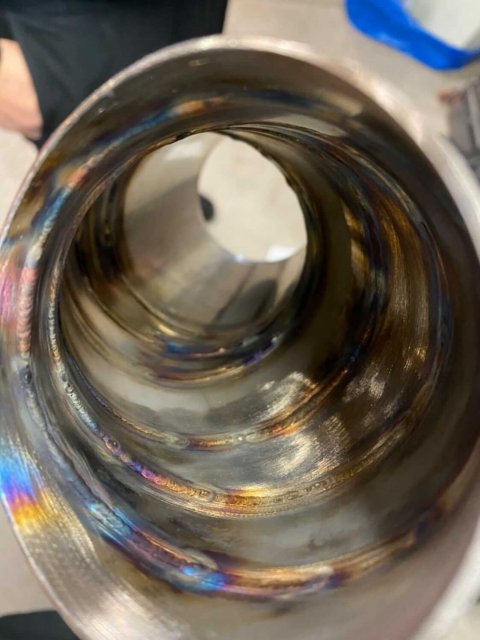

Currently in the shop and can’t wait to get it back. Everything is 3”, stainless, mandrel bent, tig welded, back purged.
Custom catted downpipes to vibrant resonators to x pipe to large magnaflow mid muffler (x-pipe design) to two smaller rear vibrant mufflers to custom dual exhaust tips. G-sport cats. Rear mufflers painted in high temp black. Tips powder coated black.
Few pics of the progress so far, I’ll add more as I get them. This is ongoing work not completed I’m sharing...o2, defoulers etc. need to be added.
Really happy with the quality so far, even the interior welds are a work of art. I will feel bad putting it under the car.
Excited to get this on a dyno in the next month or so. So far have ZFG tune (93), Whipple IC, JLT catch can, K&N filter for performance. H&R springs and Steeda rear sway bar have greatly improved handling. Also got a slightly lighter (10lbs each corner) winter wheel tire setup in 20 inches. Hoping this rubber lets me grip the road a lot better than the stock 21 all seasons.
