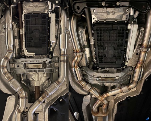

Here are ours side by side. Few minimal differences in layout and path. My resonators are further back, smaller flex pipes, and the mid muffler slightly more forward. Reading Vibrant resonator language it says “Placement further downstream in the exhaust path will target higher RPM frequencies and overall decibel reduction.” Not sure about mid muffler placement impact but they are so damn close on ours. I suppose another option would be add two more resonators between mid muffler and rear mufflers? Wish you lived closer!

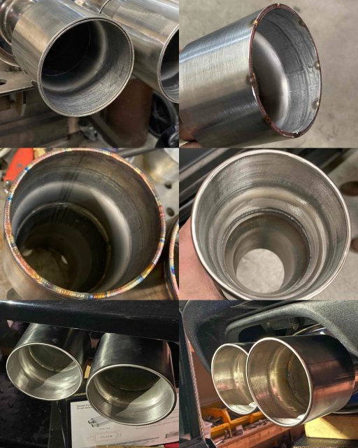

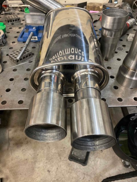

Final stages - custom tips. Will be offset (copying borla offset), slant cut, double walled and powdercoated black. Rear mufflers will be painted black to blend in. The silver muffler of the borlas drove me crazy with the car being black. Ended up doing 3.5” tips as 4” didn’t fit with the vibrant muffler layout (hit in middle).

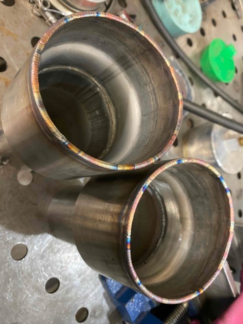

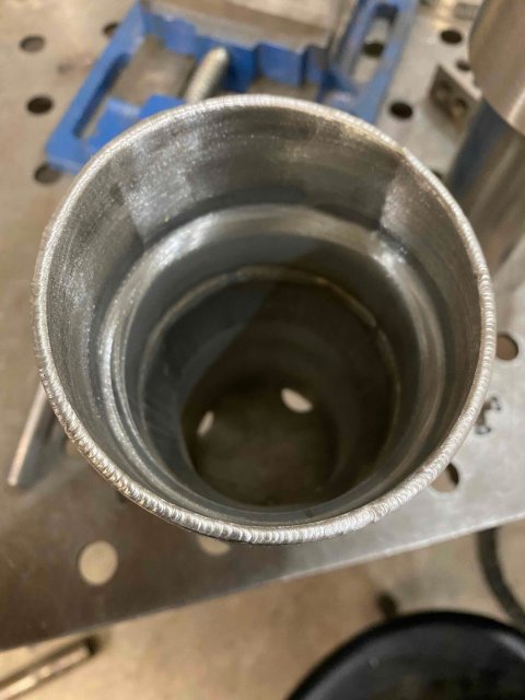

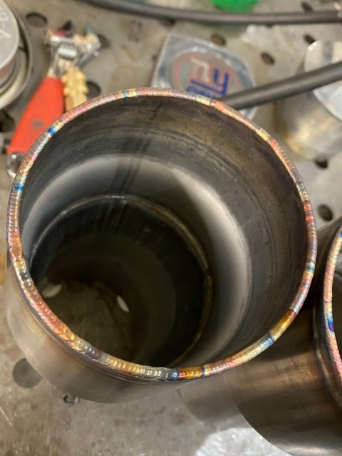

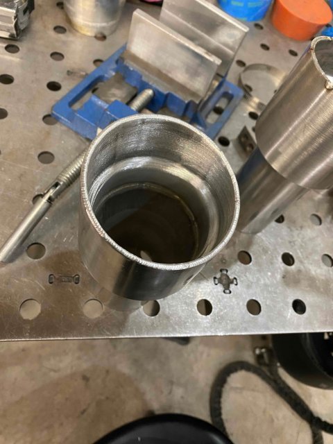

Welding the tips
9D41FAC4-BA7F-4832-87FE-5F6BCF2847B7.jpeg 679A089F-2A6C-4D9B-9FCE-42B9CFE4B37F.jpeg DF9936C0-A9A1-4007-A350-F3D989A9326A.jpeg D6BEA563-884C-4B6E-9259-14C552B1EB05.jpeg F7A5CD18-758A-4C52-9501-652246D3170B.jpeg 7F44ED58-DF19-465C-9563-3BEEE5DC2C2D.jpeg

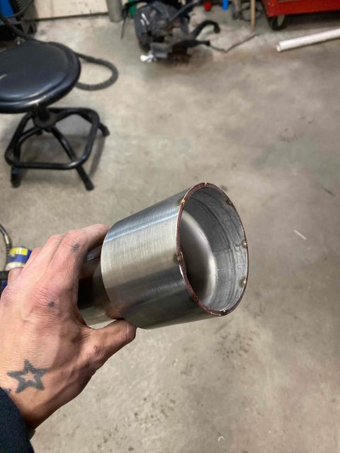

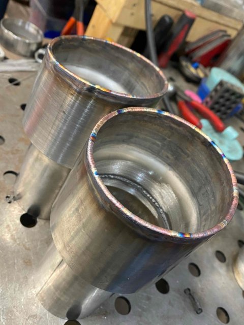

Pre powdercoat evolution. Double wall, tacked, welded, polished, rounded, trial fitment

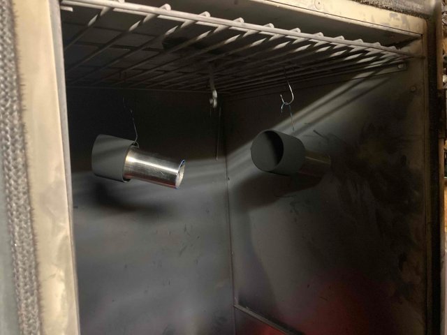

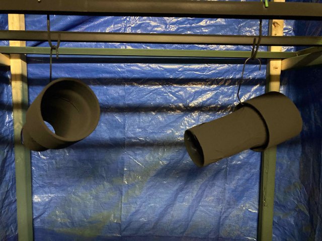

Powdercoating process. Went with a textured matte black so it will hold up better and not scratch.
