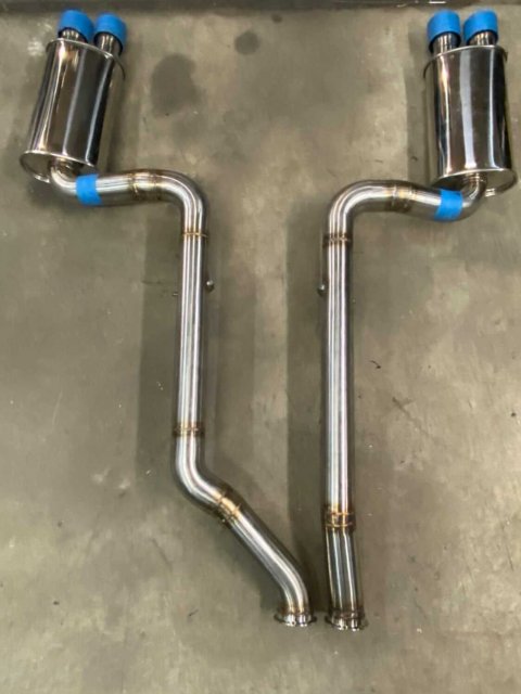

Tips powdercoat done now high temp spray for rear mufflers then mounting and picking it up. I think tonight!

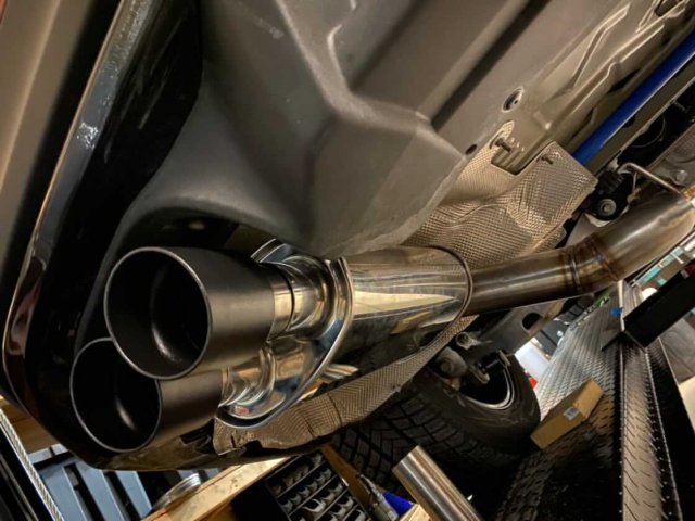

Thread Starter #83

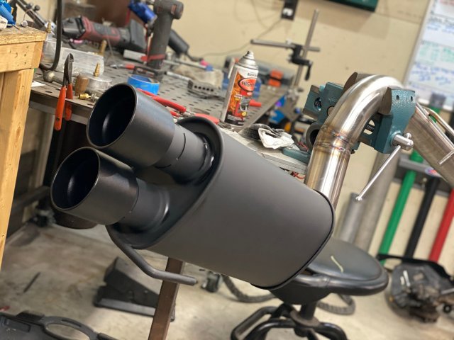

Mufflers sprayed

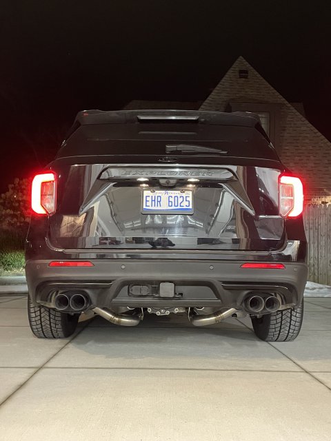

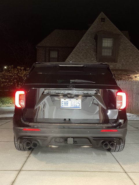

Thread Starter #88

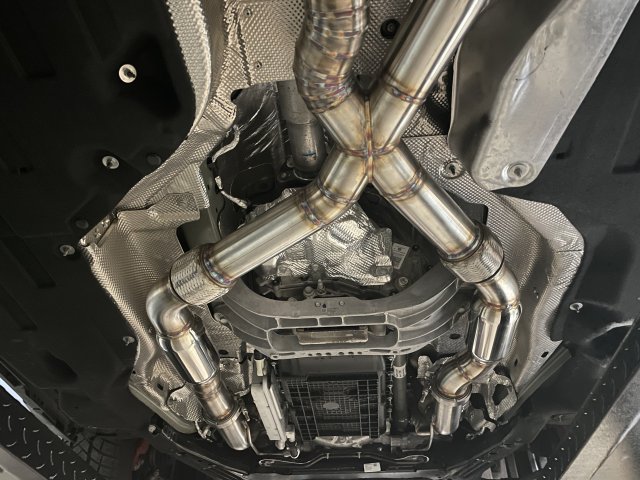

Man this looks so so mean. He said he would paint the exposed 3” piping black to match muffler and tips but I think I like it unpainted. I like it standing out and seeing the welds etc

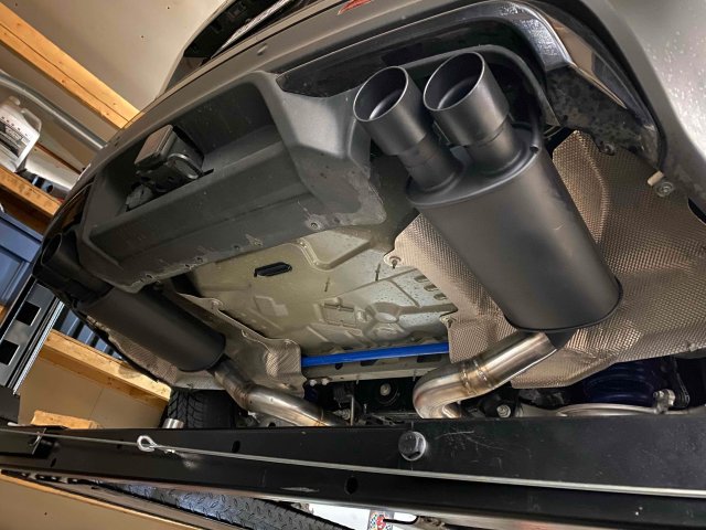

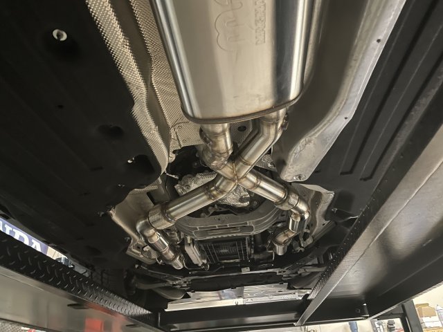

Thread Starter #91

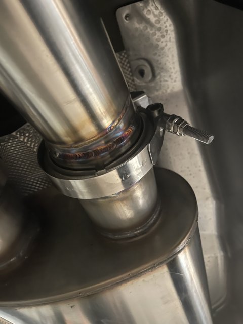

closeup video from underneath...
Kruppa Custom Exhaust Run

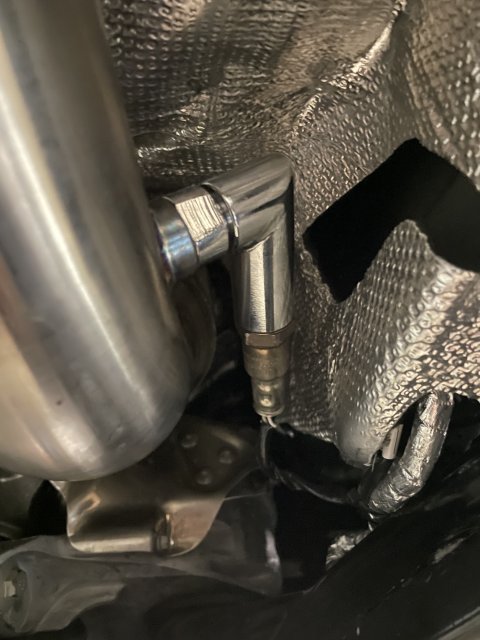

Few closeup shots including defoulers (2nd to last pic) we used to prevent any potential check engine lights.
