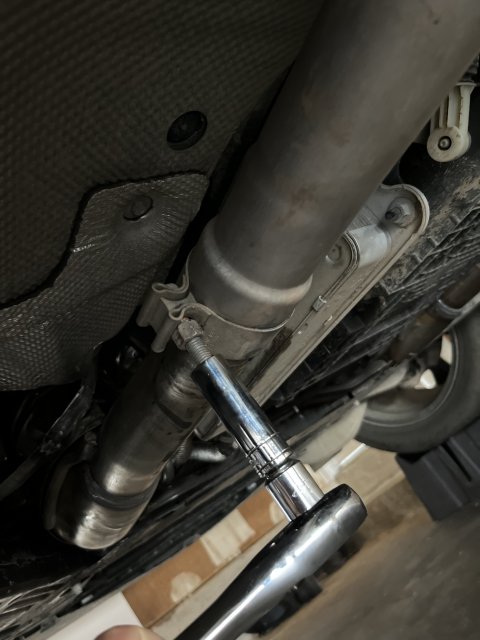

Figured I’d post an update. Tried reaching out to the dealer for a few days straight no call backs. Instead of going through the waiting/drop off game, I decided to see if buying a new LH flex pipe would help. Had to look around since they’re apparently on a long backorder, but got one locally at a Lincoln dealership for $100. Swapped it out, and in doing so, realized that my stock flex pipe clamp was missing the washer and nut bar… dealer forgot to put them back on, and therefore couldn’t tighten it down. Between missing the hardware and the rattly old flex pipe, it was making that noise. Shes solid now. Ended up complaining to the dealer and got some money back and a few free oil changes.
Glad you got that sorted out. So the Lincoln flex pipe is the same part but just Lincoln or is it different at all? Thinking of going aftermarket flex pipe if the OEMs are known to fail after a while anyway.
Exact same part. The aviator shares it. Hoping it lasts me about 15k miles before rattling too bad
